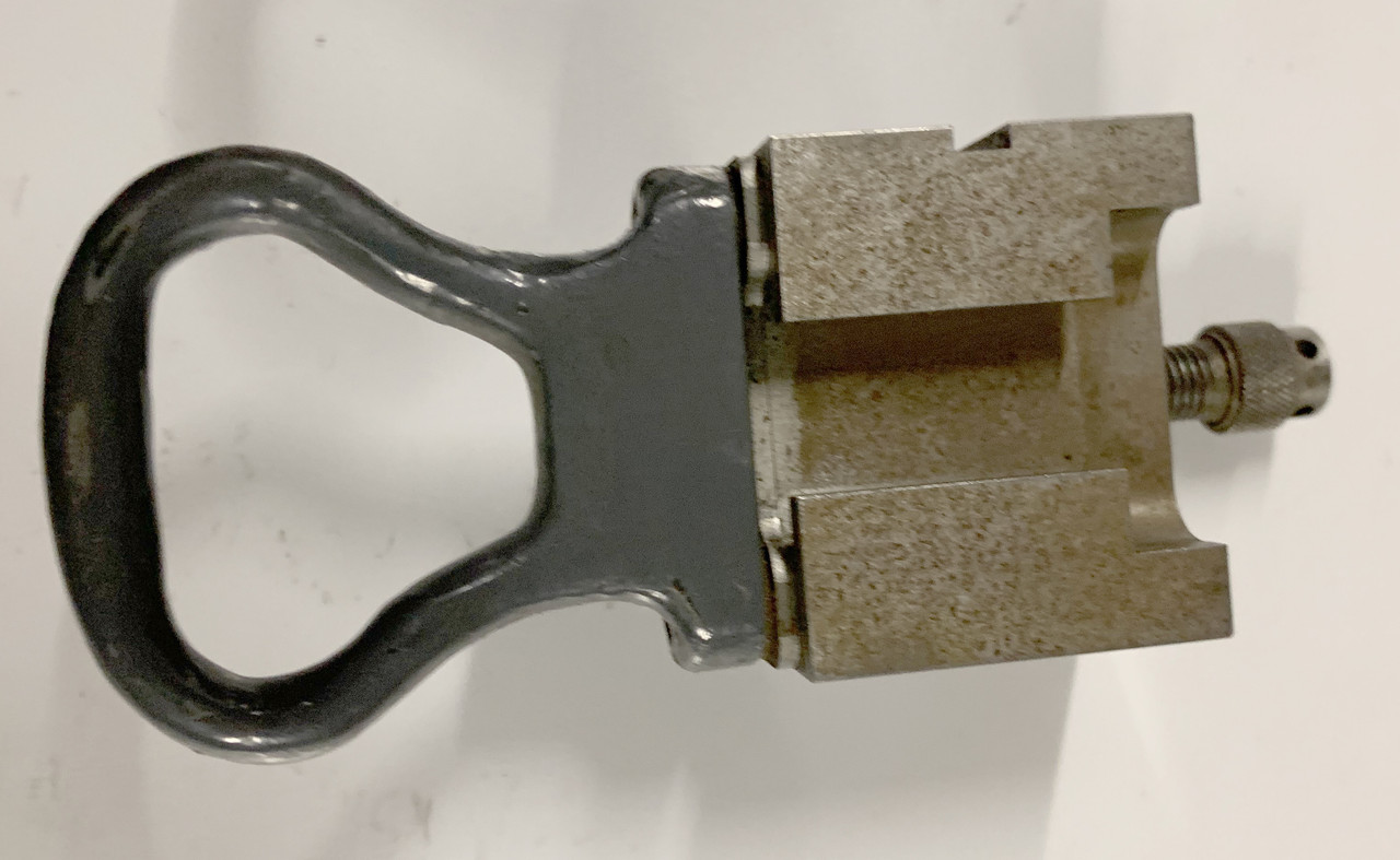

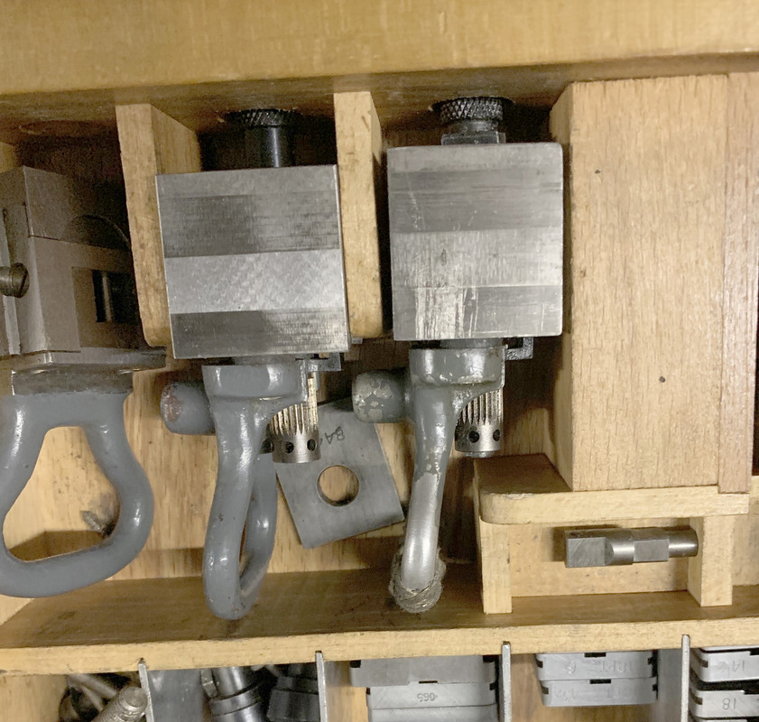

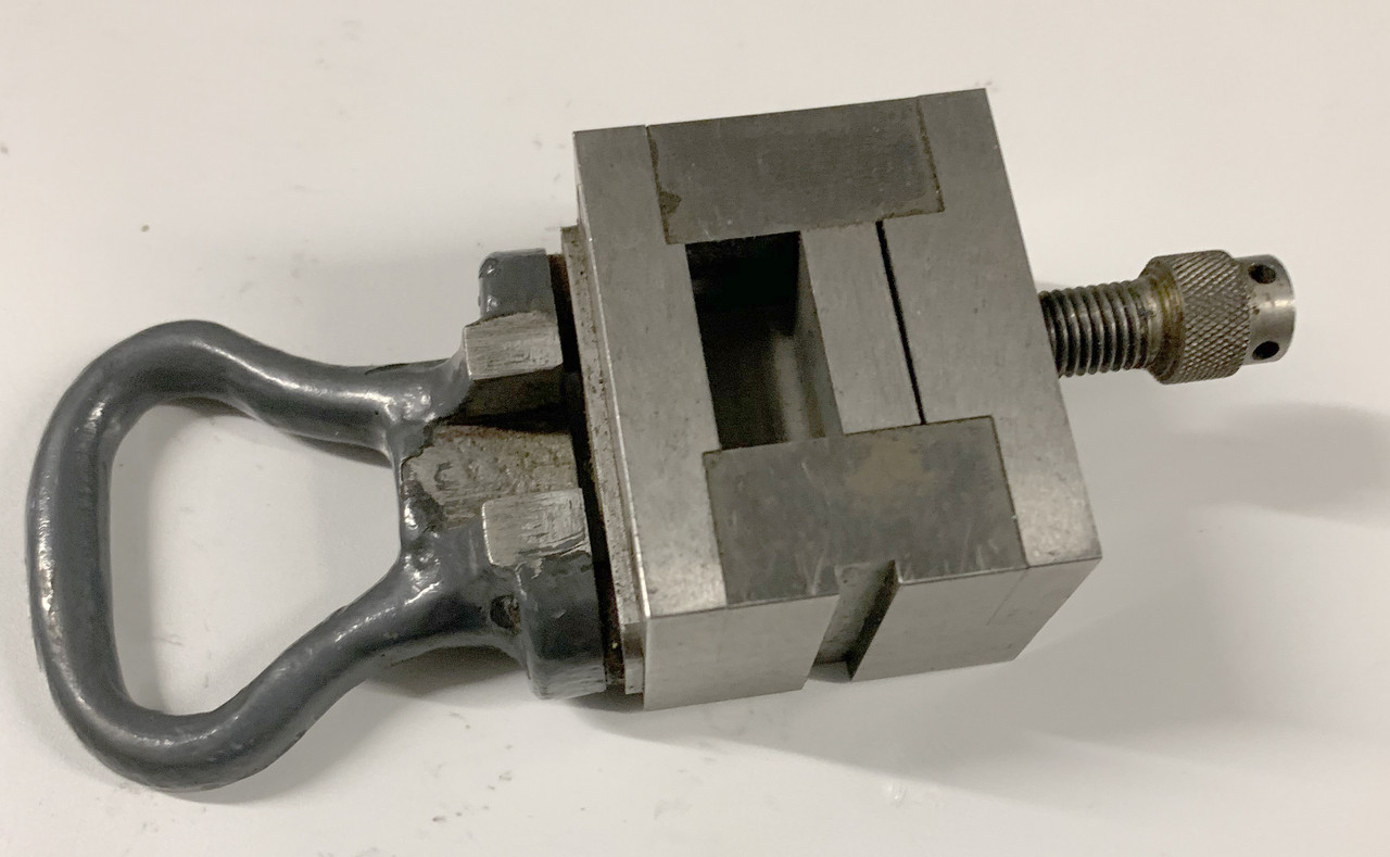

Part of what we salvaged from MMOP in Australia is one of the attached photos.
The handle on the left has 2 extra photos posted.
Am interested in any information on this, the left hand holder in the box and also the centre one, which has the very long screw.

Hi John, the holder with the long screw is similar to one that I have, see my post in Flickr
https://www.flickr.com/photos/49367257@N07/32762529907/in/album-72157704319705802/

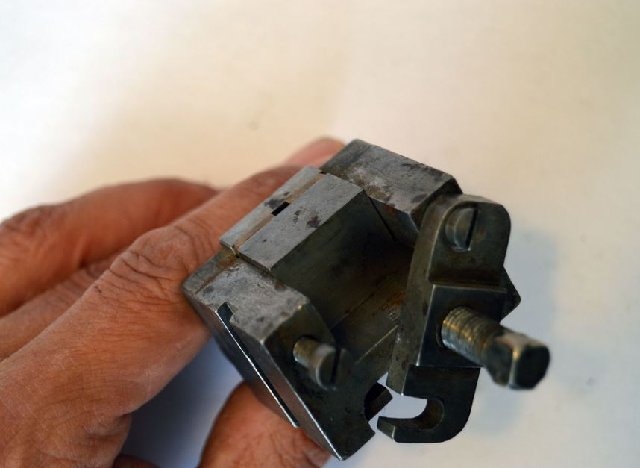

It is a custom Monotype design to hold Ludlow matrices. If that is the case then you need  to look around for the mould base and insets:
https://www.flickr.com/photos/49367257@N07/27825308724/in/album-72157679622222388/
I have also attached a picture on this site, photo by Jason Dewinetz.
If not a Ludlow holder, this is a case of Monotype making something custom for a company.
I think it is not really appreciated, however, Monotype was very good at creating engineering solutions.
They just didn't keep good records about it, and now, of course, most records are gone.
The holder on the left in the box appears to be a composition head holder, but more pictures would be needed to confirm.
Do you have a comp head for the Super Caster?

Hi Dan
Thanks so much for the info, much appreciated.

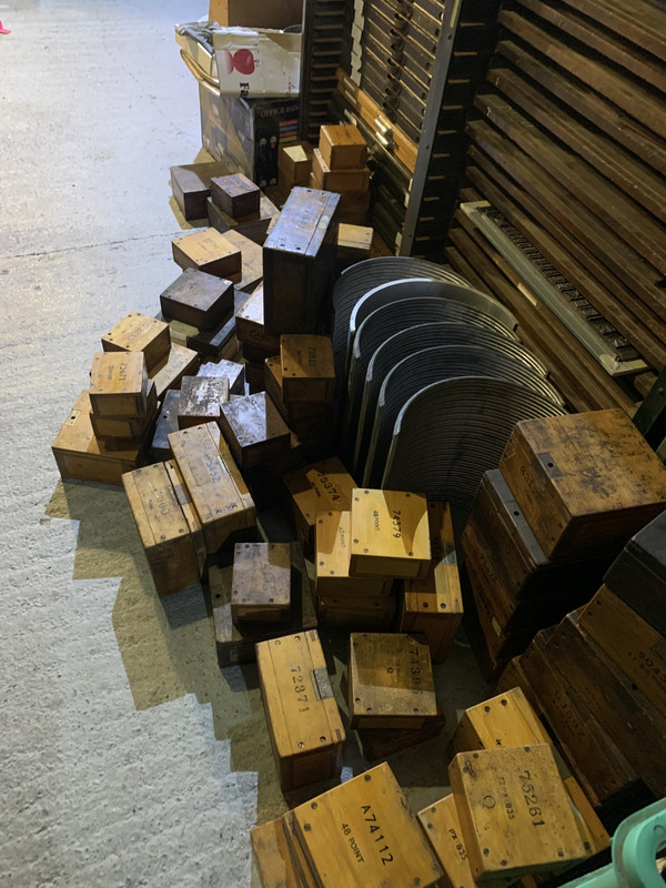

We have literally dozens and dozens of mould boxes etc. to go through so hopefully we have the pieces.

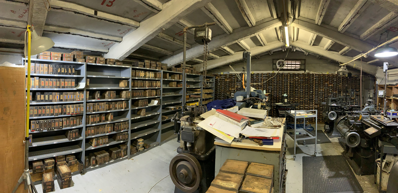

Hi Dan:
Here's a few, Newsletter under way, other exciting stuff gets in the way of completing it.
Yep, that is a Monofoto, the storage behind has the full electronic keyboard and punch.
