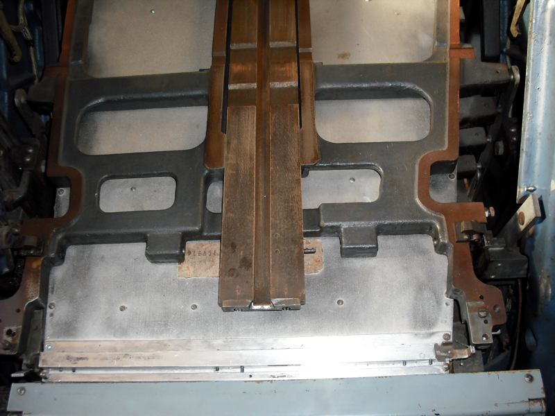

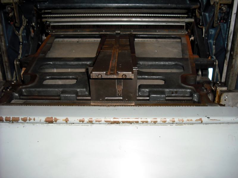

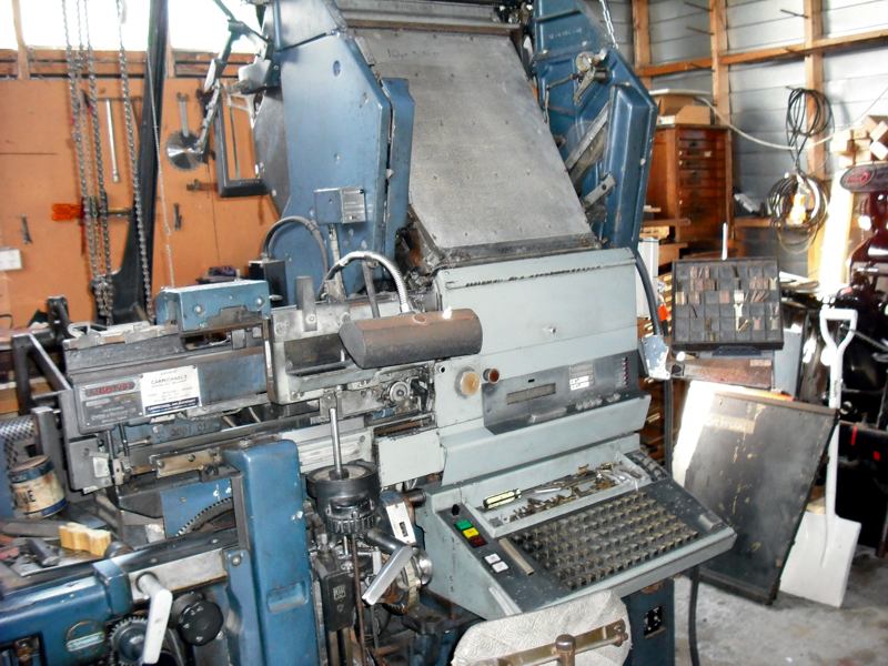

Colin has sent in some pictures of his Elektron:
Says Colin:
Quote
I have attached some photos the machine plus the pre repared magazine lift and the new one modified to take a US model 31 magazine lift.
Also my machine has a factory fitted saw which even my mechanic has never seen before
most Elektrons in New Zealand are of American Manufacture (2 left)  the one I have which was made by L&M in the UK.
Nice Elektron: envy  :-[ Those Mohr saws were very common in the U.S. and as a matter of fact, the Mohr line adjustment  appears to have been adopted on alot of machines that did not have the Mohr saw. There was a trick to using those saws; something about the line length which was set a half or quarter em longer or shorter than the sawed length to accomodate the cut. I dont remember exactly. The saw had to be oiled regularly and the blade periodically replaced. It was generally a pain, but saved time versus replacing liners. Great system but I was not keen on them. Mohr saws seemed to be particularly common on U.S. headletter machines.
Colin, from what I can see your Elektron is exactly the same as all other Elektron straight matter machines on which I have worked, both in Canada and the USA. I do not know about other newspapers or print shops but the Elektrons at The Sydney Morning Herald which were manufactured in England could all exchange magazines with all 90 channel magazine machines manufactured either in England or the USA. I know from looking at parts manuals for the English model 48 and 78 Linotypes that the machines came with the option of having the escapement as part of the magazine or as separate unit screwed to the magazine frame as in your photo. The SMH purchased an Elektron II from a commercial printer who was going out of business and that machine was the same as the machine you have pictured.
Colin emailed me direct and has pointed out some relevant facts about Elektron that had obviously escaped my memory. I have not actually worked on an Elektron since about 1965 when I moved on to Mergenthaler's various Linofilm machines. I have watched the Elektrons working at the Sydney Morning Herald up until they, with all the other hotmetal machines, were made redundant in 1984. Colin points out that the escapement on the American Elektron is hinged to the frame so that it drops away from the magazine. This sounds similar to the escapement on the model 8 and 14, but for the life of me I have no clear memory of exactly how they were attached.
So it would appear that Colin's Elektron is an odd-ball in this part of the world.
