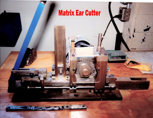

This was used to reduce the thickness of the matrix ears (lino) in order to run correctly thorugh the magazine. The mats were stacked in the magazine and pushed indivudually through under the cutters by moving the lever on the left.

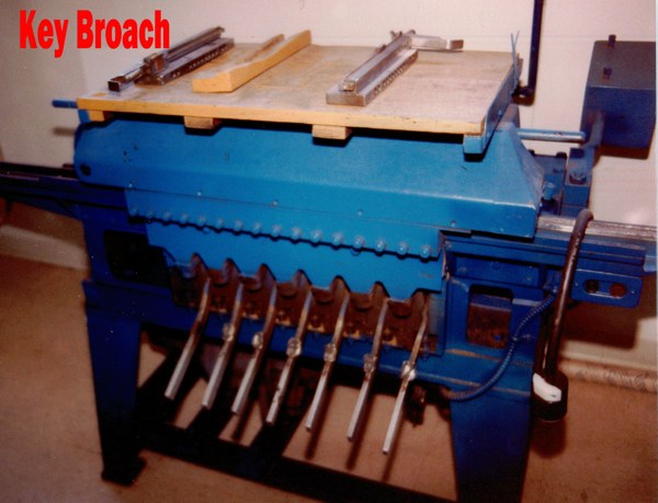

This was the broach used to create the proper key combination on linecaster mats. The levers were raised or lowered in various combinations for the particular characters being cut at the time. The mats were put in the carriers and then pushed through the broach to cut the combinations.

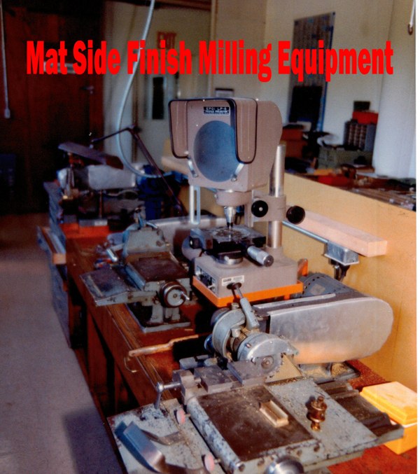

These machiens were utilized in finishing the side faces of the mat in order to smooth them and to create this correct side-bearings.

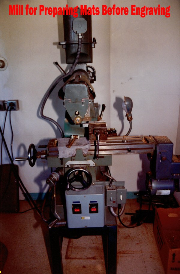

This little milling machine was capable of being changed from a vertical mill to a horizontal mill and was used to take the brass bar stock and form it into the proper format for the lino or ludlow mat bodies.

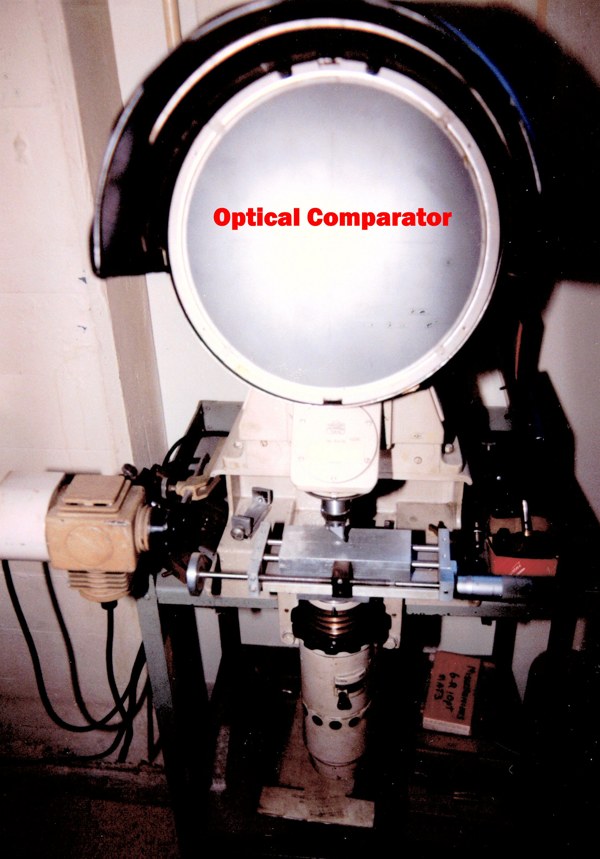

The optical comparitor was used to check for proper alignment, either using a sample from the run of mats it had to match, or using the ralative position from the edge and top of the mat body. It was also used for evaluating the cutting tool, which had to be sharpend "just so" in order to get the proper shoulder and face.

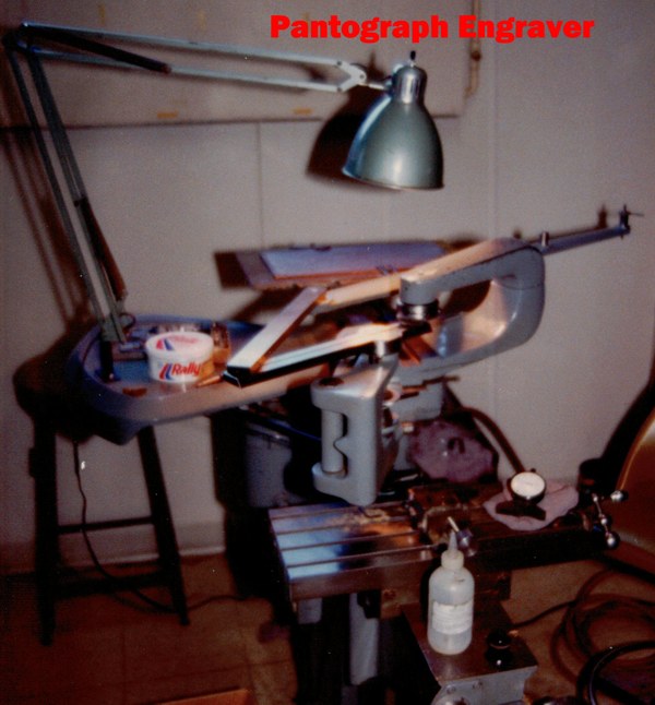

This is the pantograph engraver used for mat engraving at Kayenay. I believe most of the mats were engraved at a 50:1 reduction, meaning that the pattern plate was 50 times larger than the mat charcter being engraved. The pattern plates were photopolymer plates, and the can of car wax sitting on the machine was used to lightly lubricate the pattern plate so it didn't grab the stylus while tracing. It was important to use circular motions opposed to the spin of the cutter in order to get the cleanest floor on the engraving, which later became the actual face of the characters being cast. Of course, the last passes as you increased the depth were the most critical in that regard.

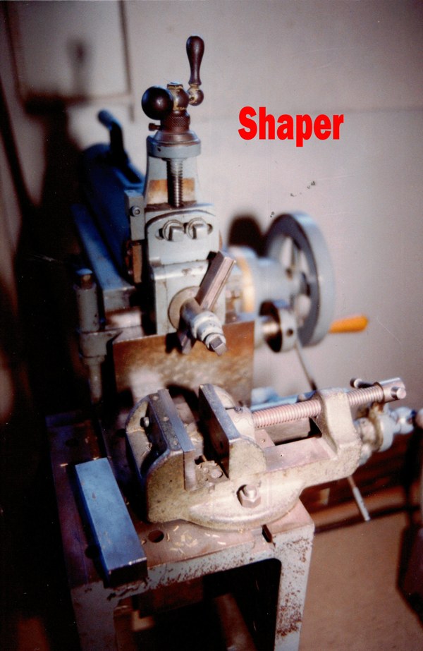

This a shaper which was used to cut border slides of rule faces. It was also used to cut the Identification and size lines on Ludlow mats where required.

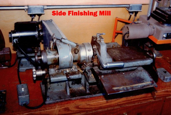

This is a closer look at one of the side finishing mills. These clamped the mat on the sliding table and the side face was passed across the face of the spinning milling head They were capable of shaving off just a whisker-width to give a good finish to the side and to give the mat the proper side-berings.
