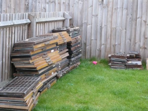

I've recently got my hands on a very large amount of hand-setting type (see photograph below, taken in the grounds of Metal Type HQ).
I'm planning on having a good sort through the stuff (it's a mixture of foundry type and Monotype) and making it available through this website. I've got the vinegar and paraffin on standby!
But my question is this: What constitutes a "Full Fount" - obviously I realise it will vary depending on whether we're talking about display sizes (14pt and above) or text sizes.
Anyone know how many of each character would be deemed to be a "full fount?"
Type storage at Metal Type HQ
