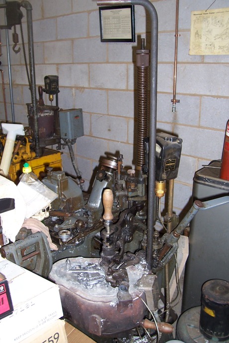

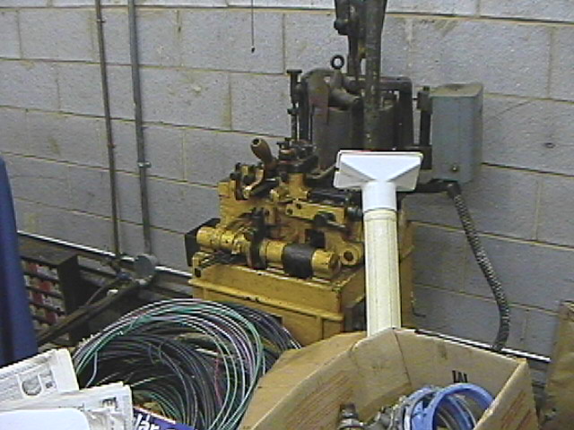

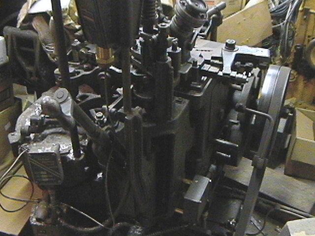

Dan Williams sent in these photographs of a Thompson type caster and an English Super Caster he saw recently, unfortunately they weren't for sale!
Thompson Caster

rag451
This is to add to Dan's photos from our trip out to East Texas in April 2007:
Robert Griffith
Burleson, Texas
www.burlesonlinotype.com
www.burlesonhistory.com
