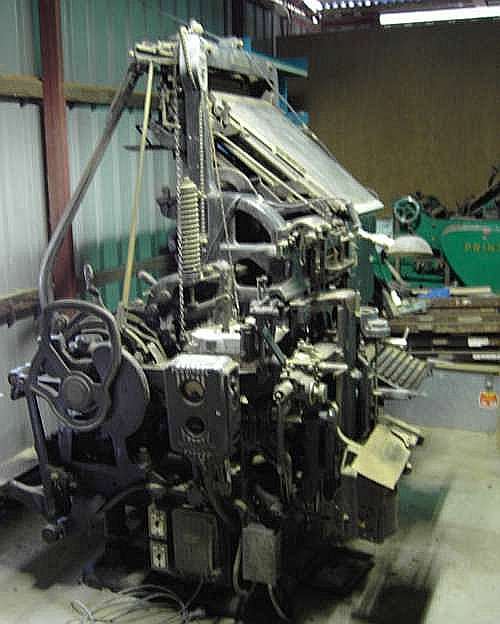

A number of years ago I reported on an abandoned C4 Intertype. I had placed some details of the machine on Metal Type (See web site below).  I managed to clean up the machine and get it to run through a casting cycle. Unfortunately the machine was missing some vital parts which made it unsafe to run and cast lines. I was unable to get the parts required so I made up an information sheet detailing  the machine and the history of the Linotype invention and Intertype's roll and gave it to the publicity officer and suggest that he put it on  the machine for display purposes. Then I more or less forgot about the machine.
Recently the Printomatic High Speed Automatic Stop Cylinder Press in the background in the photo included with the Metal Type item caught eye of of an ex New Zealand printer living on the Gold Coast. He decided to get the press ruining but wasn't sure what to do about the C4. Another ex Linotype mechanic saw an item on the internet about the two machines and contacted the printer and asked if he would like help with the C4. The Lino mechanic managed to track me down and asked if I would like to help. I agreed that if we could get the parts it would be worth the effort. Now we have a lot of hours ahead of us just cleaning away years of rust hardened grease and dirt just to get the machine to a point where it is worth replacing the parts. Sounds like fun.
