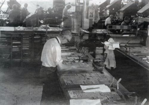

OK for starters here is a picture of someone carrying out the work of a stonehand:
It involves arranging the type into a page, and perhaps several pages into a forme for printing on a press.
This guy is working on single broadsheet newspaper pages.

From what you say your grandfather probably served an apprenticeship as a compositor or maybe as a hand and machine compositor. Compositors had various duties and a stonehand was one of them. Dave has already given a description of the stonehand's duties. They are called stonehands because the surface they worked on was originally made of stone Other duties of a compositor was to hand assemble foundry type from fonts (individual characters of a particular type family) to forms lines of type to be part of a printed item. He may also have used a Linotype or a Monotype keyboard.
