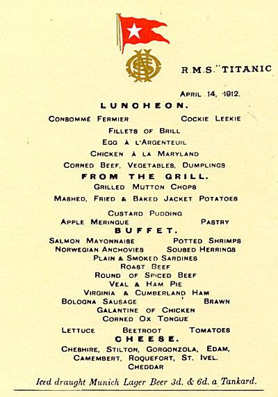

Now to the 'Rosemead Menu'.
This was an honest reproduction to be used in conjunction with a dinner to commemorate the 50th anniversary of the disaster and as part of the publicity for this occasion - it did not conform to any of the regular White Star sizes and included the 'Beer' eye raiser - quote -   'Printed at the bottom of the "Rosemead menu" is this wording followed by a thin black line and the bank information : Iced draught Munich Lager Beer 3d. & 6d. a Tankard. Courtesy of the FIRST CITY BANK 123 South Lake Ave., Pasadena and Valley at Rosemead Blvd., Rosemead, Calif.'
The description of the job suggests a not so hot small offset job of inconsistent quality  -  some of the pieces sold as collectibles after this event had the Bank information trimmed off, which reduced the height by the amount of the trim,  the while some others left it on.
Perhaps Iced Larger beer was available on board the ship - this could be genuine - the price seems to be about right for a higher end market of the time.
Which leads me to a question or two about the menu on the back of the painting - was the piece a stock White Star size and did it have the beer ad, the line cutout and the bank ad.
The bank ad would be a dead givaway so it would probably have been removed leaving the cutout - also a giveaway because it is out of character with the rest of the setting except to draw the beer and bank lines together as a unit.

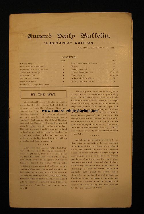

I was unable to find an image of the Titanic newspaper (perhaps it is now rarer than the menu cards!) - but I did find this image of the Lusitania's newspaper.

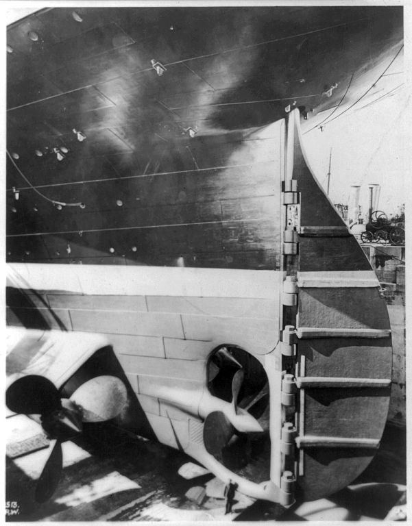

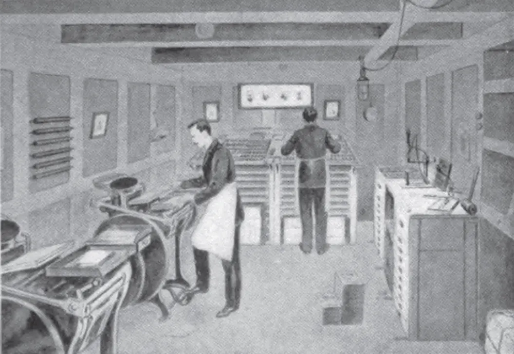

This picture of the Titanic's sister ship, Olympic seems unremarkable until you notice the human figure and are able to scale the ship!
This illustration of the office of the Cunard Daily Bulletin seems a little clean and tidy for my liking!
This blog claims some information regarding the print shop on the Titanic. It includes the above photo of Ernest Corbin, the assistant printer.

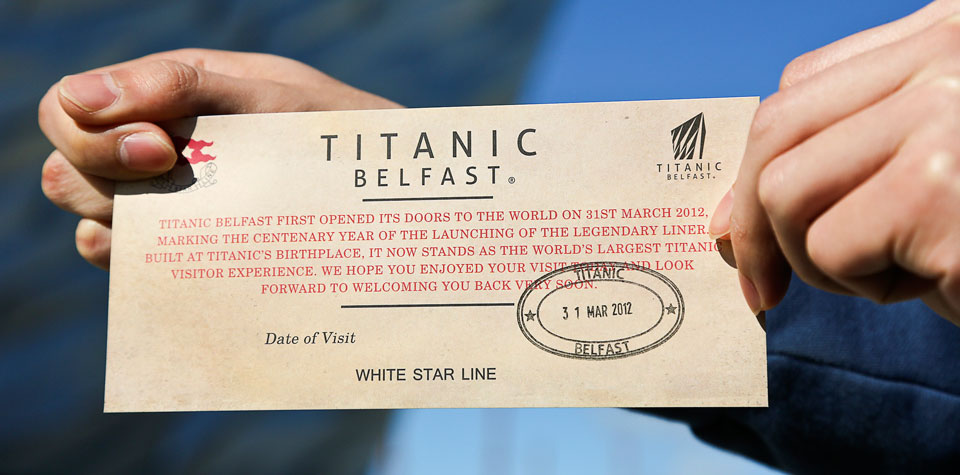

A huge "visitor attraction" (hate that phrase) has opened in Belfast, with all sorts of artifacts, etc. on display to the public.
Their website: http://www.titanicbelfast.com features a "vintage looking" ticket.
The long all-cap lines seem to spoil it for me. I would guess they are trying to mimic the original menus, which had much shorter lines.
