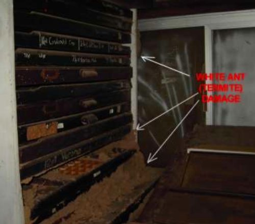

White Ant (Termite) Damage
Termite damage
In addition there are dozens of cases of handset type, but the cabinets have all been eaten out by white ants, a real problem in this part of the world. The cases have all collapsed down on top of one another.
The termites eat all the timber and leave a shell. As they do not come out into the daylight, unless you see the dirt they produce they go unnoticed until the structure collapses. They do not eat cedar or hardwood, so I assume the trays are made of cedar. Remove the type trays and the cabinet will collapse.
