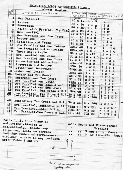

Book imposition chart
Said Dave: “Given to me when Composing apprentice at Billings of Guildford when I moved on to the “Stones” for tuition, now coming on to 60 years ago!
“The question of a “Boy” was why these pages had to be laid in such a complex order on the Stone.
This explains why, because the sheets needed to be folded in a specific way to relate to the chosen imposition Scheme and form a “signature”.
The book lays out what extent the Stonehand’s life was governed by an exceptional memory and dexterity of hand with his tied-up pages slid from the galley into position, chased and locked into the forme.

Note the final sheets of 4 feet by 2 feet 6inches. Even larger were monsters for the 128-page backed up imposition “N”, often churned out from the pair of sliding beds on the large letterpress flatbeds that broke your back in half if you were unlucky enough to be lumbered with the “Machine Revise”, not to mention doing it over a forme recently scrubbed with trichoethylene!
