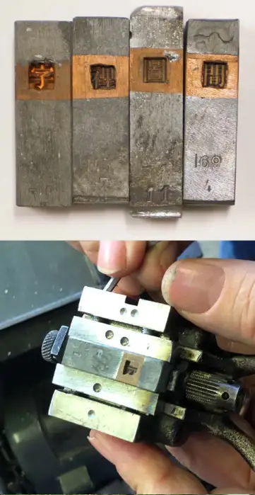

After my first visit to the warehouse of the Wereldmuseum I did some experiments with a single matrix in the Type Foundry in Westzaan. Some practical problems had to be solved. Our Monotype Supercaster was not designed for the 19th century matrices. But with some adaptation of the matrix holder we managed to recast one of the Hong Kong types.
In December 2019 Ms. Yung finally came over to Amsterdam, where we visited the Tetterode Archive in the University Library, the Wereldmuseum and the Foundry in Westzaan. The printed specimen of that first type marks the moment that an intensive cooperation started.
At that time Seewhy NG joined the project. During the Covid lockdown, she was able to identify the 5000 Hong Kong types in the overall collection of 9000 and she assisted with the casting of the type. And finally, we were able to produce a set of type just in time for the exhibition ‘Between the Lines’, where the recast Hong Kong types formed a high­light.
The technical challenges encountered during the recasting however meant that the original plan to recast the entire collection of 5000 types was not feasible. 25 types a day was the maximum amount we could handle. Adjusting the caster for each indi­vidual type took 5 to 10 minutes. Type lovers should also realize that the European standard is based on Didot points and the Hong Kong (English) system on Picas. Another consideration is the difference in type height. Furthermore, the matrices were not all of the same depth. We solved these problems by planing down the type to the correct height after casting. The character size of the original Hong Kong Types and those in the Dutch collection is exactly the same.
