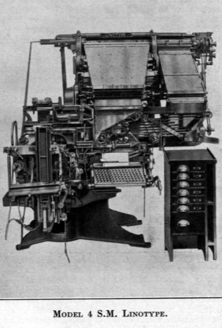

Linotype Model 4 with Side Magazines
The Model 4 S.M. is similar in all respects to the Model 4, with the addition of two side or auxiliary magazines.
This machine has a standard keyboard of 90 keys which releases matrices from both the main and side magazines, and all type faces and body sizes from 5-point to 36-point can be produced in all measures up to 30 pica ems.
If specially ordered, the maximum line measure can be increased to 36 pica ems.
A single distributor works over main magazines, and a double distributor over side magazines.
This model is fitted with the universal knife block and universal ejector.
